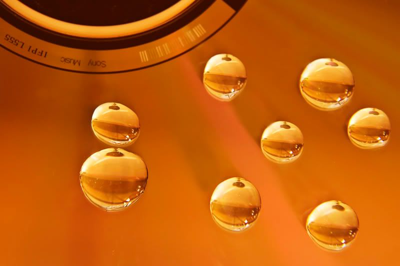

Okay, my submission using a close up filter. No cropping, but marginally desaturated, and hue changed slightly (? +5) to strengthen the image. Some small scratches cloned out. Resized in PS to 800. CD with water drops added for interest: Can you see my hand?
Can't you see? It all makes perfect sense, expressed in dollars and cents, pounds, shillings and pence: Roger Waters.
A700, Sig 10-20, 17-70, 70-200, Min 24-85, 28, 50, Vivitar 100 macro, HVFL 42AM
Date Posted: 14 February 2010 at 20:42
@Berean: Ian, Can you provide a bit more information about the lens and diopter rating for the closeup filter? Thanks... Brian
Posted By: Berean
Date Posted: 14 February 2010 at 20:58
Sorry, Brian: I wasn't thinking. Sigma 28-300mm f/3.5-6.3 DL lens (about 12 years old) from my Minolta days, that came with a free Sigma close up filter (72mm diameter) but no other information available. Allowed me to focus closer to the water droplets, from approximately 1 metre to roughly 30cm.
Date Posted: 15 February 2010 at 07:08
Berean, looking at the picture it seems about 1:2 (on the sensor, which is what counts) so it's more close focus then real macro, which theoretically only starts at 1:1. Eyeballing it looks you have a length of 4 to 5 cm on the CD. If my calculation is off let me know, but otherwise pls. try again with something with a higher magnification.
Nice shot btw, I like the reflections and the very warm toning.

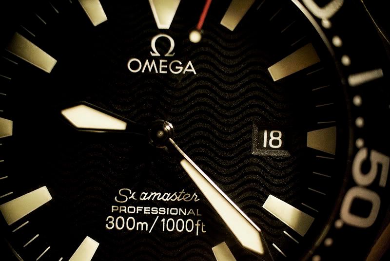

Ok! hereīs my first try at an advanced assignment, it may not be enough but if itīs one thing, itīs beyond 1:1.
Hereīs a detail shot of my Thors Hammer.
a700 reversed Konica Hexagon AR 28 mm f 3,5 handheld 1/60 sec with Sigma 530 flash bounced in roof
and 1:1 with Sony 30 mm 2,8 for comparsion.
Regards Christer

Date Posted: 17 February 2010 at 06:43
ChrBra, forgot about that one . I saw it but didn't have time to react and didn't come back to it. Good you "bumped".
I think sharpness suffers a bit using that lens so close, but there's still plenty of detail and texture to see for a pass.

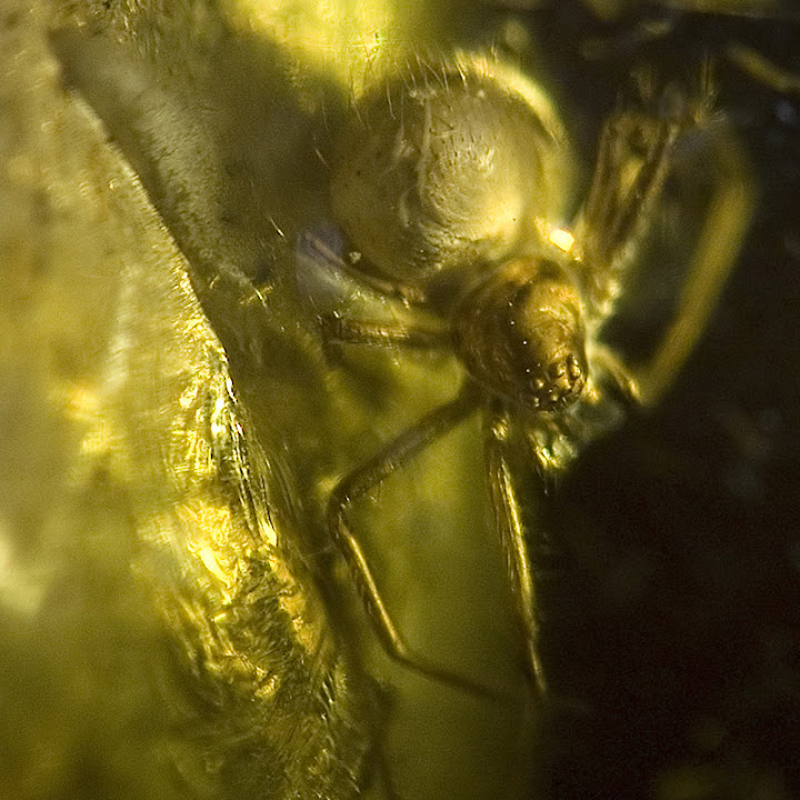

On display here is a 30 million old spider embedded in a piece amber.
I found the amber on the beach on a photo trip to the White Cliffs of Moen. Nothing was visible when I first looked at it at the beach, but when I came home I decided to polish it. And what a joy to find this little spider trapped inside.
The photographs is all taken with my Beercan + a reversed Prakticar Pentacon 50 mm f/1.8
I didīnt attach the 50 mm to the Beercan, I just held it in front of it. This complicates things a bit since one hand is occupied by holding the 50 mm.
My lightning rig was a bit odd. I placed the amber on the glass on a 12 volt torch light. On each side of the amber I placed two small diode lights with very cold light.
I had to shoot at ISO 800 which caused some grain, but in at least one of the photographs I think it adds to the overall mood.
The pictures isīnt as sharp as I had hoped, but to be honest I donīt know why. Shutter times was sufficient to prevent motion blur and mis focusing isīnt the problem.
It might be simply because the amber isīnt 100% clear
Photographs is taken with my 7D - ISO 800 - aperture between 9 and 22 and shutter times from 1/160 sec to 1/640 sec.
All pictures is taken hand held but with my hands resting on various objects.
The spider is approx. 1 mm long

Date Posted: 20 February 2010 at 09:27
A beautiful object Heyckendorf. Indeed a nice story about finding it. Nature's treasures are everywhere but this is a very special piece.
As far as the assignment, a flying colours pass I would say, I especially like the colours in the third, but all are good!

Pegelli...Thanks for your comment. Feel free to move my entry to The Dyxum Open views due to braking the regulations here
ChrBra...I always had some troubles with rules I must admit
Regarding the photographs I also feel it very strange that this little spider, after so many million years, still look like it was just trapped inside the resin minutes ago. Itīs so strange to think about how the world looked that particular day the spider met his or hers final destination.
What a magnificent preservation resin is.
After I found this piece of amber I started digging the internet for more about insects in amber. My search brought my attention to a Danish woman called "The Amber Lady" living in the north west of Denmark. She has the worlds biggest collection of insects embedded in amber. More than 80.000 pieces of amber containing more than 120.000 insects and other animals. She even has a piece with a small lizard in it...isīnt that amazing?
Unfortunately I haveīnt succeeded in getting in contact with here. Iīd really like to take more pictures of amber insects.
alphatini...great magnification. You say itīs just a reversed 28 mm? Does that mean that you just hold it by hand against the mount flange of the camera?

pegelli...here is two...just two...un-cropped....I repeat un-cropped versions of the illegal photographs
About the 1:1 magnification iīm a little confused. To be honest I donīt know what that means? 1:1 of what?
The spider is approx 1 mm. 1:1 would then mean that it had to be 1 mm on the screen?...nahh....1 mm on the sensor? ..maybe...1 mm on a paper copy straight from the camera then?....nahh donīt think so either.
Here is a link to the http://netnatur.dk/netfauna/rav/arkiv/ravfruen-i-skagen/ - Amber Lady
Itīs in Danish but iīm sure google can translate it into something very hilarious
Itīs not here own website I think. The pictures of the amber pieces clearly shows she could use some more inspiring photographs of the amber insects
http://heyckendorff.blogspot.com/ - My Blog

Date Posted: 04 May 2011 at 08:31
cant decide which works better.. anyway here i goes for my second pass! pics straight off camera.
found this little spidey hanging in my backyard; this is him hiding in a green tupperware lid. abdomen equals 2-3mm
