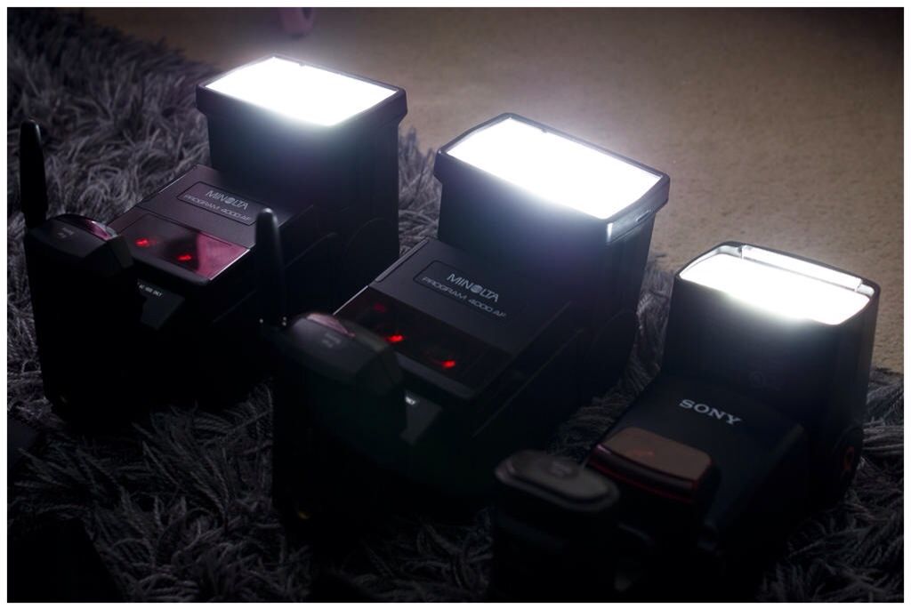

As Mud.Starrr mentioned CT-301p ... I have recently got the CT-301... (this version is without the PC sync port) ... and I'm trying to use it with to trigger my Minolta Maxxum 2800 AF flash.
On my camera, this old flash syncs @ 1/200... But, with this trigger, the fastest possible sync speed just drops to a very very slow shutter speed... like 1/25
... even at the speed of 1/30, the dark patch of the shutter curtain starts to appear in the frame... and at anything faster than 1/30, it just fires totally out of sync... with no effect of the flash in the exposure.
Any idea how to correct this? ... if it's the problem of the trigger... can anyone suggest me any other trigger that will go with my old Minolta flash (preferrably, without any modification)?

Oh thats because they made a mistake with a wire in the system.
You just have to make a extra wire from the battery-plate to the foot.
Its really easy, you don't have to solder anything.
The wire on the battery site just squeezes in by the battery, and the other half can be set under a screw thats already there.
1 minute work and they work perfectly, the good thing about these triggers is that they rarely have misfires (most of those cheap ones do have that problem).
Here is how to do the little mod: http://www.flickr.com/groups/strobist/discuss/72157612529839420/ - Flickr

Thanks Mud.Starrr, I did exactly as you said... and it worked like a charm!!! Thank you sooo much!!
My Minolta 2800 AF flash is now syncing @ 1/200 !! ...What a jump from 1/30!! ..Although a very slight darker top can be noticed at 1/200 ... but I can live with that... knowing that it syncs perfectly at 1/160 at least!!
Thanks again... and yes, I do agree with you that these triggers never misfire... when I was restricted to 1/30 I noticed that too!!

Another proof of concept, this time using a cheap china made trigger PT-04S1. I'm using the method that sibersitizen has posted for both PW+2 and PT-04S1.
PT-04S1
ebay link for the PT-04S1 http://www.ebay.com/itm/DSLRKIT-Sony-Flashes-Trigger-PT-04S1-w-Umbrella-Holder-/330430247835
